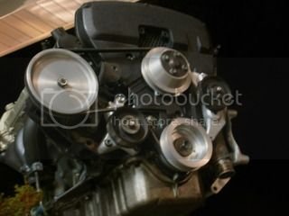

i forget the name of them but the company shosource goes threw can make you a whole set of UDPs still even tho the website says they dont make them anymore, just takes longer to recieve them is all.
i was gonna order a set off them but instead i found a set from someone local and i got the 4 piece solid pulleys like the ones in the picture they guy has on this thread and if i was to give a number
id say probley 10 hp at least because it was a noticable difference when i put them on and the car revs much nicer that the 20 lbs crank pulley is gone
i had to do some searching and playing around to find the belt sizes which if you like i can give ya the belt sizes to help out i got from napa
