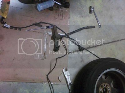

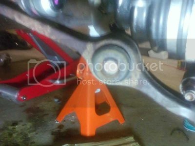

I forgot how much fun it is to use an angle grinder.
anybody else ever done this before? I'm sort of ****** still but a bit of destruction made things a bit better:
