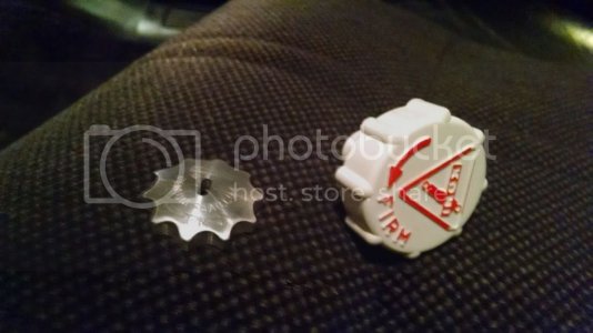

Alright Chad. Here's a picture next to the regular ****.
Koni20adjustment20knobs zpsis0hinwn
On the **** it had a website (genuinesaab.com). So I went there and found the tool.
http://www.genuinesaab.com/catalog/product_info.php?products_id=828
I hope this helps!
