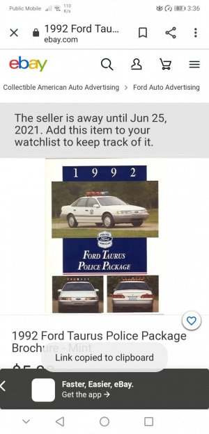

Yes the 92 is only came with the standard Taurus SHO parts. Some police departments did use them for interceptors back in the day. But if I recall no special upgrades.
A few Mustangs and camaros too if I recall.
Found this on eBay.
