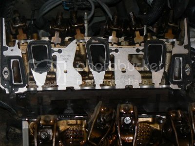

Matty... Honestly.. I've heard things about felpro's rotating seals... I personally have bought Ford Cam Seals, and Front and Rear crank seals. Just a real pain in the butt to get to them, over a 3 dollar savings. If it lasts a week longer, its worth 3 bux to me.
As for Head gaskets, and intake seals, and such.. Fel Pro is great... just something about the round ones.. Just what a few lil birdy's have told me anyway. My Fel Pro gaskets for the Malibu were nothing short of sexy compared to the plastic ones GM made. :)

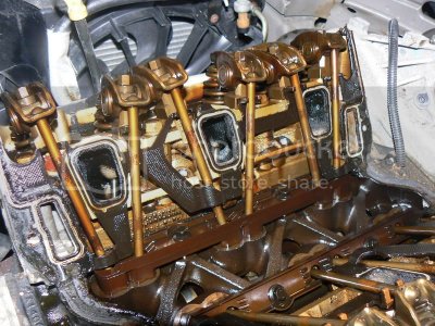

And GM's stock idea of a Lower Intake Manifold gasket

Holy cow, what a difference in engines!
