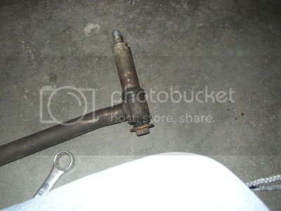

here's a photo of part of the rod shifter. you have the rod which shifts and then the other rod that gets bolted into the trans. this part that the bolt goes into is called the boss.
this is a photo showing my bolt(incorrect for the car) and my bushing(visually distorted and damaged):
PA020057
in the car it is supposed to look like this(The one I am talking about is the one closer to the top of the photo):

On my spare MTX , the boss hole is also fubared. Im bringing it to a welding place (they weld alu plus they are good and cheap) , have them fill the hole flush. Then you either drill and tap , or you can drill , tap and helicoil it - its going be be even stronger.
For that bolt you may want to get another one from the guys here in the WTB section.
For the bushing , some energy suspension bushings that can be trimed on a buffer to fit this might do the trick.

Is there any chance that you have the "width of a nut distance" of original thread left in the housing?
Without knowing anything about how it assembles, could you create a stud (original thread size) that would stick out of your casing that the rod (that is bolted to the tranny) could slip over.
That way, you never disturb the original threads in the case again.
You can reinforce it by welding (?) or any of the liquid metals that people rave about.
The forces are not trying to pull the threads out, so if you get it snug in there and provide lots of contact area for the stud and casing to "seat" itself in, it could work.
Just a thought without knowing much about the issue.

the guy who drilled it out didn't drill all the way back so there are still some threads in there. there looked to be enough that it could still sort of function. What I might look at doing is a mix of turning an excessively long bolt into a stud or even a 12mm diameter section of steel rod with threading on both ends, a boss brace from Jose, a fresh energy suspension bushing. Anybody have the specs of the bushing so I know what to look for?
