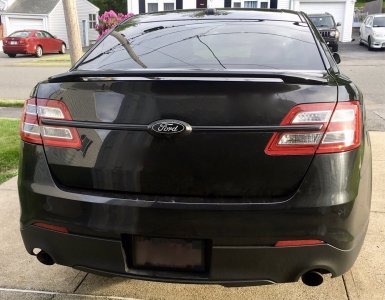

I removed my Taurus and SHO emblems using dental floss and some goo gone. There are YouTube videos on removal of car emblems. You use goo gone to soften the adhesive and the dental floss in a back and forth sawing type motion to cut through the adhesive then I used the goo gone to soften the remaining adhesive and rub it off. The FORD logos are vinyl overlays from eBay specifically sized for the Taurus grille and trunk. C396169f3a1f5847b6002874e5b2a102
