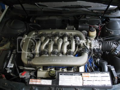

Can anyone show me a pic of where this might be on my SHO? I live in MD but bought my car used. It's a 92 mtx and shouldn't have one but I think I do.

Right beside the throttle body, on the firewall side, bolted with other crap on the rear side of the intake manifold. It's a big silver round thing with a black vacumm line hooked up to it and has a long pipe running down to the rear exhaust manifold.

Since your car is a 92 MTX, it won't have EGR unless it was originally sold in California. I doubt that yours has it.
In this picture of my ATX, the EGR is located on the intake manifold, directly in front of the alarm siren and to the passenger side of the brake reservoir.

I see it, and nope I don't have one. Thanks for the pic to help me. I appreciate it.
