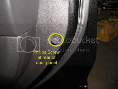

3. Remove 1 Philips head screw inside rubber bumper at the lower rear of the door panel.
Rear screw

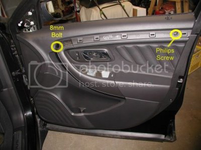

6. Pop the pseudo carbon fiber trim loose from the rear of the door and gentle unsnap it working forward.
7. Remove the two fasteners behind the trim (Philips screw at rear, 8mm bolt at front).
Tricky

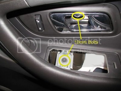

8. Remove the 2 – 10mm bolts from behind the door handle trim and underneath the power window switch assembly.
Bolts

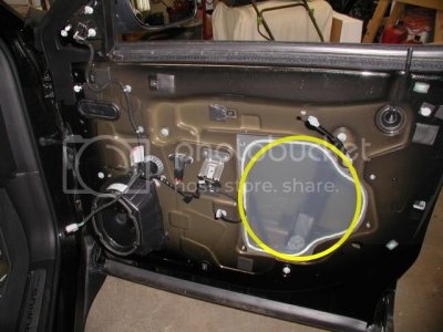

I think my “rattle” was actually caused by a drum head effect of the plastic covering the access hole for the power window regulator. I placed a piece of Dynamat in the center of the plastic to see if that will quiet things down.
Rattle
