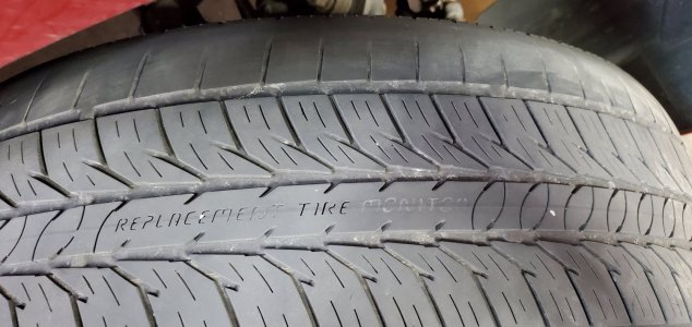

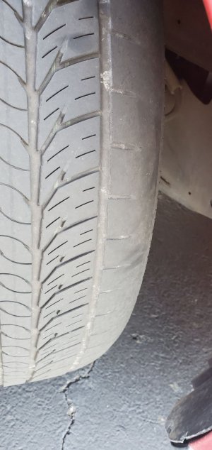

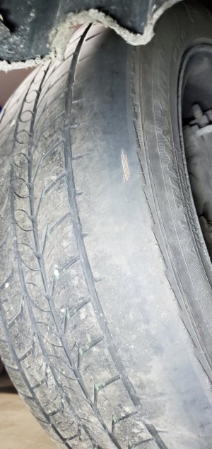

So I was doing my 245k mi oil change and I noticed some cords showing through on the inside edge of my front passenger tire. The out side edge sill looks ok, and the 'Replacement tire monitor' is just starting to fade to 'Replace Tire'. I've noticed it wearing the inner edges before, and I've rotated the tires and have had the alignment checked/done a few times over the last couple years, and it continues to eat the inner edge of the tires. Is this common for these cars? Is the alignment shop botching the alignment? I have lifetime alignments there so I've always taken it to the same place. I'm gonna try to get new tires put on it tomorrow, and I'll see if I can get the alignment checked there (different shop).

Inner edge (or shoulder) wear occurs on the inside edge of the tire and is usually caused by excessive toe out and/or excessive negative camber. If the tread depth of the outer shoulder is at least 50% greater than the tread depth of the inner shoulder, the tire is experiencing inner edge/shoulder wear. To determine whether tires have this type of wear, visually inspect the tires. In some instances, it may be necessary to measure the tread depth of each rib and compare it to that of the shoulder.

Take it to the dealer where they have the proper spec for your car, or at a min don't take it to the place you've been using. Excessive toe will cause a saw tooth wear pattern that you can feel as you drag your hand across the tire. Wearing the inner edge is excessive negative camber. Wear in the center of the tire is over inflation. Wear on both outside edges is under inflation. I rotate front to rear and cross rotate the rears to the front every 5k miles. I also stick the tread depth L-C-R on each tire when I rotate and adjust air pressures as needed. It's a bit of a game, but it works, it all starts with the initial alignment being correct. Too much negative camber and not enough air will show much more quickly as you have 2 factors working against you. Toe angle will cause the fastest tire wear, but results in a choppy saw wear pattern. Capiche

Based on the pic, that's negative camber. That it's happening on only 1 corners means that either, you've got something worn in the suspension (bushing), OR, at some point, you hammered a pothole or something, and knocked the alignment out ever so slightly. Especially if you hit the same spot, doing the same rout. Repeated hits will progressively knocked your alignment out.
Add to that how heavy these cars are, and how aggressively we tend to drive them (at least, I do), and the wear can get excessive very quickly.
