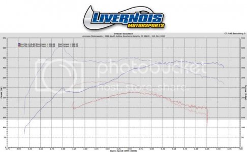

Here is a graph from Darreli's 2010 SHO.
The car has the following mods:
Livernois Motorsports Catted Downpipe
Livernois Motorsports Methanol Injection Kit
Livernois Motorsports Dyno Tune
Corsa Exhaust
CAI
The factory turbo housing was modified and it was fitted with a larger billet wheel.
Before numbers were 277 WHP / 371 WTQ after numbers were 435 WHP / 521 WTQ. (If you get rid of the initial spike in the baseline, it made 330 WTQ stock)
Shoturboupgrade
Looks at the gains... it's up 190 WHP / 225 WTQ at 6,250
The car has been a best of 12.00 @ 117 mph in the 1/4 mile, but even with 4 drag radials spins through 3 gears since he can't heat them up.
Thanks for looking!
-Rick

I hope you guys are looking into driveline upgrades...that is some serious torque to move such a heavy vehicle, in that amount of time.

To date we've had zero failures of any kind. Darrell's car has been modded since new and has 48,000 miles and another member with the same mods as him has been modded since fairly new and has over 80,000 miles.. both with a lot of track passes.

Sounds like jealousy.....
I bet the ride from 2-3k is a whole helluva lot of fun.
Jealous of what? My 4-banger makes that kind of power. If I saw that peak on a turbo Subaru I was tuning, I would address it via WGDC, cam timing, etc. This is why I asked the question.

Rick, what numbers have you come up with at the motor. Do you think you broke the 500HP barrier with all his upgrades.

Isn't all wheel drivetrain loss somewhere near 25%? If so, 25% more than 435, is over 500 :)
The thing that really impresses me is the torque. I think the AWD loss is probably more than 25%, but even at 25%, the torque would be over 650 ft-lb if it's 521 wheel.
