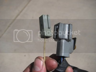

So I am in the middle of the 60k front maintenance and this connector on the left:
Shosenser4
ends like this:
Shosenser3

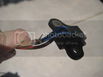

It's the frayed metal wires sticking out on the top.
Whats the deal? is it broken? Seems to me it should go somewhere.

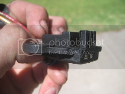

Also while removing it i chipped the crank sensor:
Shosenser
Will that affect the function of it at all?

IIRC the bare metal wire is simply a signal shield wire and intercepts electromagnetic interference (EMI) before it messes with the crank signal.
The chip should not affect the sensor. It's not where either of the magnets are.

It's called a drain wire, and I agree with everyone else, might as well replace it while you're in there.

Is the bare wire suppose to attach something? Does it ground to one of the 2 mounting screws?
jmpSHO
Mar 15, 2009
1,157
131
Massachusetts
No it doesn't attach to anything, did you not read what Hawkeye said? It would be best to just replace it while you have it out and the car apart.

Yes, I read what he said. But he didn't mention specifically if it plugged into something or was affixed to something. I haven't encountered a loose wire like this before while working on cars.
