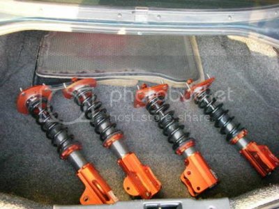

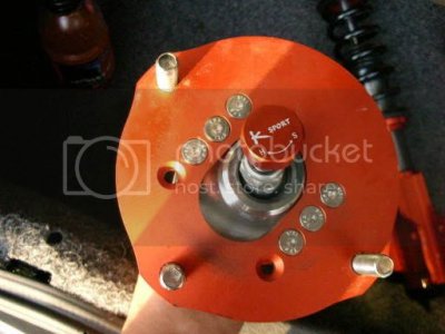

a "real" setup has struts that are designed for coilovers, .here's my friend nicks setup for his 91 pgt:
DSCN0281
DSCN0283
and i was asking out of curiusity...yeah,i noticed about the group buys..but there are somethings that people would cough up the money...i guess you'd have to rid in a car with them to fully appriciate a well designed setup

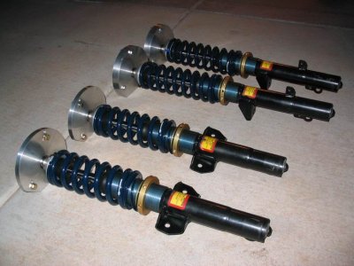

Judging by the strut mounts, they look like Gary M's coilovers. The IPTs were black painted steel, and the the GC one use the stock mounts.
Shoaz
Studly dood
Mar 25, 2003
4,637
593
Scottsdale, AZ
NWGRN94MTX said:
Are those Morell's?
That's my set from Gary's parts run, yes. They're currently on the Pumpkin.
Gary's personal set is, as always, cleaner and shinier. :D
