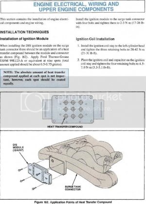

The factory service manual is wrong. This has been hashed. I will paste out of the 89 SHO Engine Service Manual:
Untitled
I don't know what you interpret "thermo-grease" to be, but I call it heat paste.
No, the factory service manual is not wrong. The dielectric compound specified also has the needed characteristics to serve as a heat transfer compound. It is not the same as the stuff at AutoZone.

Go to radio shack and get their little $4 tube of heat sink compound/heat transfer paste. This is the stuff you need. As *cough* others have stated, dielectric grease will technically work, but much like wrapping electrical tape around a frayed battery wire, it isn't the right solution.
Once you get the correct compound (and yes, the exact compound Ford specifies is indeed a form of heat sink paste), you will need to clean the old stuff off well to get the maximum benefit. Isopropyl alcohol and cotton balls work wonders.
