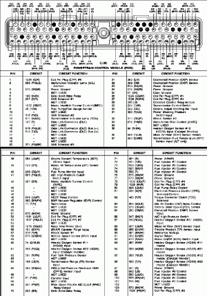

Should be less than 5 ohms between the signal return (ground terminal on the plug) and pin 85 Dark Blue/Orange at the PCM.
And Less than 1V with the key on and engine off between pin 85 and ground.
The bottom row is the top when looking at it in the car.
97 pcm pinout
