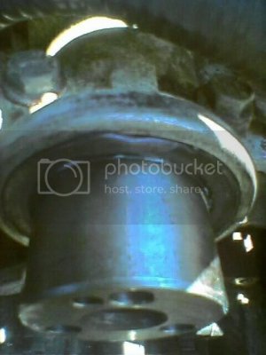

I had a similar issue when I installed the felpro cam seal set. Every seal I'd try to install would come out looking like this. . . . . . 1188033624 ORIG
I ended up going with the Timken (1213N) seals from AZ. Not a drop of oil afterwards.
