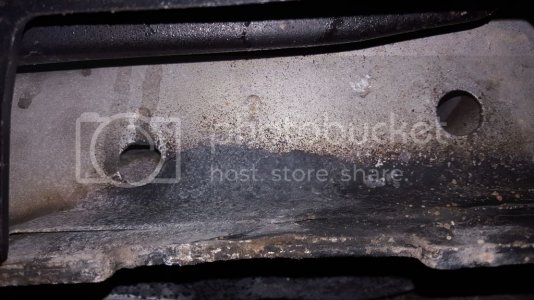

In taking the measurements, I noticed the pinch weld on the passenger rear factory jack point is split and one side is bent outward - like only the corner of a lift pad was placed just on the edge, where it caught the one side, but not the other, causing it to bend outward. Awesome.
Damaged20pinch20welds
I was hovering around the bay when the tech was working on my car, not watching him per sé, but just talking cars with various people, like the GM (very cool guy) and the tech (who was surprised his F-150 EcoBoost gets far slower 1/4 mile times than me... I'm still scratching my head on that one. :huh:) Anyhow, I do recall thinking my rocker panel looked weird when the car was on their lift, like the placement of the lifting pad wasn't right and was squishing it a little, but it's plastic, so it's fine... and I'm a very trusting person and I've been a customer for many years, etc., plus I'm kind of a noob when it comes to working on cars (only about a year now) so I didn't want to presume to tell someone far more experienced how to do his job.
Anyhow, now that the pinch weld is jacked (haha) wtf do I do?? I already feel unsafe lifting the car myself, but not so much I can't get it done. (That's an arguably healthier attitude then being like "who gives a crap, just get it up there, it'll be OK.") Now I feel even less safe, knowing there's a particularly weak point on one of the lifting points of the car. :( Plus - he damaged my baby... there are just no words. I'm extremely ******. An extra quart is easy to fix and easy to forgive. This has me just freaking mad. :madflame:
OK, rant over... seriously, what do I do with this? I can't prove it was him, so I'll likely have to pay for it to be repaired... but can it be properly repaired? Seems to me that once metal gets bent, it's never quite as strong, so I'm also wondering is there a way to reinforce these as well? Any thoughts, suggestions, etc. are welcome.

I think what you're looking at is normal and it's that way from the factory. I looked at all 4 jack points on my Taurus and all 4 jack points on my wife's Kia and they all look like that. They all have the little bent area. I think you're fine. Look at the other jack areas, do they look like that also?

just to be sure we're on the same page, you're talking about that little flared out piece right?
First you're making the assumption that makes it weaker in any significant way.
Second, I bought my wife's Kia new and it's never been to any shop. I do all the work myself and have never jacked up the vehicle by the pinch weld. I know it came that way from the factory. On my car I bought it used, but find it very unlikely all 4 we're bent and bent the same shape. I'll take a picture of mine tonight.

I took a picture of the back side of the jack point. This is what it looks like if viewed from the center of the car out towards the side.
As you can see, that bump looks like it was formed from the factory. There's no distorted or cracked metal that would be caused by bending from a jack. Additionally there are 2 spot welds right next to it (all of this is the same on all 4 corners). My guess is they flare it out and then back in order to give it some additional rigidity on the horizontal plane. It would help keep the weld from folding up towards the body.
What do your other 3 non-bent corners look like from this view? If they're flat there must have been some sort of redesign from 2010 to your vehicle year.

Well, it's certainly interesting that you have that flare there - which I agree clearly looks manufactured. However, you may have noticed that mine doesn't look manufactured but damaged. I've already stated that they weren't that way before I took the car to the dealership, and I noticed it afterwards when taking measurements. Believe me, there's no way in **** I'm gonna sit here and rant if all the pinch welds were the same just based on how it "looks" to me at the time. No, this was damage done at the dealership, just recently. As stated. However, I do appreciate the attempt at consolation, it was nice of you. Sadly, it's definitely a case of sloppy worksmanship resulting in damage, which is heartbreaking.
Anyhow, in case you're not convinced with my simply saying so, I photographed the other side for comparison. Other than it being a 2012 in the rust belt (therefore not looking nearly as spiffy as your pinch weld) you can see that there's no flare of any kind, neither manufacturer imprinted nor damaged into existence:
Normal20Pinch20welds
Now, having demonstrated that it isn't "normal", does anyone have any ideas how to fix it? It may not seem like a big deal if they're doing that on purpose on later models, but there's a very big difference in strength between metal that's been forcibly bend, and metal that's been formed or tempered into a particular shape.
I'd be happy to hear of any and all remedies, be they reinforcement, etc.

I have bent steel and straightened steel on so many cars in my life...
I own a car that I restored myself and every corner was dented at one time.
I welded 156 holes "previous damage dent puller" and smoothed the metal on every panel.
Clean the area up and buy some etch primer and maybe some spray-in bed liner or undercoat.
use a body hammer and dolly to straighten the metal.
I would be more worried about all that SALT on the underside of your car rcryniak....:rolleyes:
Looks good to me! SALT FREE diet?

There must have been some change between 2010 and 2012 as your points look different. I would also follow what Pintony said and straighten the metal. Then if you want to make sure it stays in place, clean the rust/grime off and lay a small weld to hold everything together. Then grind it flat and paint to avoid corrosion.

oh wow, do not bend that metal back the 1/8" it has been deflected! it will fatigue the metal and compromise the structural integrity of the car!!

If the metal is bent bending it back will weaken it further. Every time you bend it the metal stretches a little more. But alot of it depends on the type of metal, alloys and tempering.
Ultimately yes, bending metal will weaken the metal and it's called stress fatigue. It's called work hardening as some of the metal stretches but some also is compressed so it's not as simple as stretching metal. Depending on material, how it's bent, and to what extent it will cause work hardening of the metal. For aluminum, any slight bending will cause it to slowly fatigue. For steel, there is a minimum bend before it will start to fatigue.
Seeing as how the actual bending on the OP is pretty minor and not at an extreme angle I doubt there's much weakening. Additionally, welding the bottom together would more than make up for any lost strength due to fatigue. Plus, heating up steel is a way to alleviate metal fatigue. So if he's really concerned then he can get a torch to heat it up while he bends it back.
Bottom line is I seriously doubt it matters what the OP does to that little piece of metal. He could leave it, cut it off, bend it back (w/out weld), or bend it back and weld it and I seriously doubt it's going to make any difference. If it was mine and I did anything I would bend it back, clamp it in place, weld it, grind it flat again, and paint it. I wouldn't think twice about metal fatigue in that location with that minor bend.

Thanks for the input, SilverSHO. I will probably do just that.. however, it can clearly wait, but I'll keep my eye on it, just in case.
