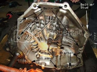

OK. Now it seems I am missing a bolt for the tranny. Does anyone have pics of where each bolt goes? My Chiltons lists 2.studs 3 bolts then it shows one more bolt. I only have five total that were removed. Is there a spot that is supposed to be skipped? It wouldn't be a problem if I had not taken the car apart in April.

This shows the bolt pattern
MTXboltpattern

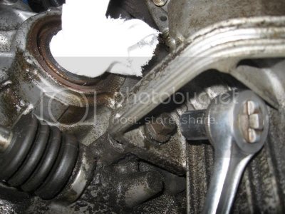

This bolt is kind of hidden; could this be the one?

Thanks Bob. That pic is perfect. I have three bolts and two w/studs. I do have the two in the oil pan also. I have a dust shield and bolts on the way that I got from Kelvin. I knew one of the studs goes in the top the clamp for the p. steering hoses and I figured the other one holds the small metal L bracket the starter wires are connected to. The original owner did the clutch at 50k. Who ever was in there lost one bolt and the inspection shield. Cut the fender liner to gain access put the bolts back in the wrong spots etc! Also left a 15mm Blue Point ratcheting wrench. LOL
