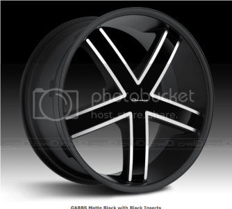

I think I found a set of wheels I like for my car.
Screenshot2010 12 04at30428PM
They come in 20 or 22. I would have liked a 21 inch wheel so I could put lower profile tires on it and lower it. But I think I would have to stay with 20 and put the stock size tires on it. Does anyone know if a 22 will rub? I have a feeling it will, and is it safe to put that size rim on the AWD system?

Thanks, I have a white SHO with tint and I think the white accents will really pop.

They come in 20 and 22 from carid.com. It has you put in your car so I guess they are custom made to our bolt pattern? Price is $475 a wheel but I just found out that what I thought was white paint is actually chrome so I wont be getting these. Shame as they would look awesome...

Wheels for SHO or Flex EcoBoost need to be a minimum of 40 offset with 8" wide rims (stock is 38) and 35 would probably be the ideal offset. If you go wider... need to use a program (available on line - offsets) to see what is ideal. Say you are going to 9" rims, the offset would be more like 40-42 to get the same outside fender clearance.... but you need to verify with an offset calculator.

Yea I saw that before but I would never order from a third party like CarID. Rather go straight to the manufacturer. thanks

These are Giovanna rims. Ever see a set of rims by a bigger company than Giovanna, say HRE or ADV1? About $1500 for one rim.

Those dont really look like the rims I'm looking at at all.
