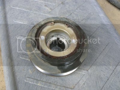

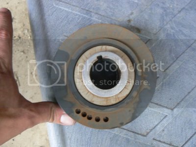

Lookie what I found.... pics of ur pulley...
P1080319
P1080318P1080317
Nice clean threads.. almost looks like someone went a hour down the road to find a Lowes or something to get a new set of taps because maybe the old holes were too small and the old bolts pulled out.. ;)

Yea, just got me a stock one now, that one split . I think I found what I had and they were discontinued because of doing exactly what mine did... Splitting into

Well, those stock ones fail in that fashion normally. Boat had one come apart a few years back on his. I still say the one you had was off something else.. There were some 2 peice aluminum pulleys back in the day, I figured someone would have recognised it.
