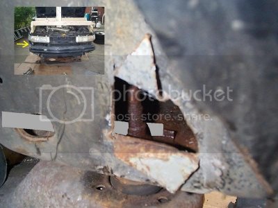

Like this...
Cut a hole in the frame rail...I drew in a tire iron to show you how to get the nut to hold still...just cut the old bolt and pull the remnants out of the hole you cut since you have new bolts/platenuts.
FrontpassSFbolt
Or remove the battery tray(pass) airbox(drv)...there's already a hole there.

FrontpassSFbolt
Ignore the hole in the frame. If you are lucky, you can get a combo wrench in the hole I drew a tire iron going through
