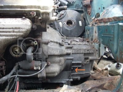

I am in northeast Wichita. We should get together sometime. I have a 94 ATX and a 91 MTX. Have other SHO guys in Wichita, me, Joe, Siman, and a few others not on the forum. We also Have a guy in Hutch. To answer your question, their is no drain plug on the MTX, only a fill plug.

I hope you did not remove the detent plunger retaining bolt, but you'll be soooooorrrry. That could explain no reverse.

there's a plug in the bottom of the tranny, it's a bolt looks just like a drain for oil..... drained and reinserted

That plug won't drain all the old fluid out and it is a fork interlock retaining bolt. It should not be used to drain oil. You have a 92 right? Have some one look under the car while you shift. It sounds like your rod shifter has a problem. You probably have quite of bit of slack in the rod and the gates of the transmission are not meeting up.
