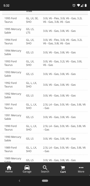

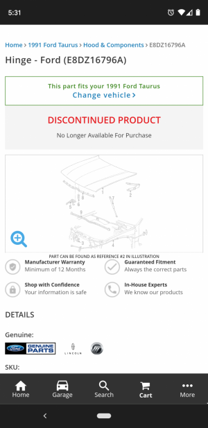

They shouldn't be. The hood and fenders were the same on the SHO as the other trim levels, so the hinges should be interchangeable between the trims.
The part numbers are E8DZ16796A for the right hinge, E8DZ16797A for the left hinge.
Those part numbers pretty much cover all the 1st Gen Taurus (86 - 91) and and all trims, including the mid cycle refresh from 92-95.
