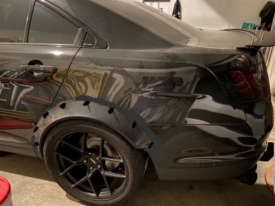

I have 13+ rear rotors and calipers on my 2010. The 10-12 dust shields are too small though and such a stupid design, you can’t remove them without removing the bearing/hub assembly. I cut mine off and just won’t have a dust shield. 520816B0 37FA 415F A37E F5F63E3BD1AF

I have 13+ rear rotors and calipers on my 2010. The 10-12 dust shields are too small though and such a stupid design, you can’t remove them without removing the bearing/hub assembly. I cut mine off and just won’t have a dust shield. View attachment 83378
So are your rotors vented then? The ones I have are supposedly for a 2016 SHO, are vented and 13 5/8" in diameter. The old ones are non-vented and 13" in diameter.
Ya, I left my old dust shields on up front when I did the upgrade. Under certain circumstances once in a while they rattle against the rotors. Had a big WTF moment the first time that happened. It sounds exactly like a metal radiator fan hitting a metal fan shroud. Dating myself I guess....
Looks to be almost 13-7/8 but yes the larger ones. I just sort of missed the bus on the technical data. These are R1 Concepts rotors not OEM. Being passionate about cars/trucks/motorcycles is timeless so no worries on aging yourself lol. Is this what dating yourself looks like? 365C58C0 31FA 4472 8F5D 40924998DFFB
