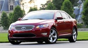

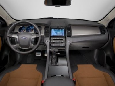

Numerous styling changes mostly, inside and out. Front end exterior wise most notably as well as updated center stack and instrument cluster interior wise. I think there was also some minor updates engine wise which probably aren't worth diggin' into honestly.
'12 W75cqxKJJbeTFNBpACI0bR3m SCZb s80RcLNoCKGY6muRpR1Q '13  OpcJoLxrzL5UfEvpZDWKlVe03 2BPEI3YSZxWBhCQj 4mCriQ
'12 2011 taurus interior '13 Upload 2015 4 21 15 49 9
I went with a '13 due to the interior updates which I thought were better than '10-'12s.
