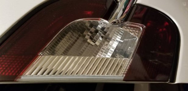

This was bugging me, so I went into the garage to double check for myself, and YES! Lostneye is CORRECT!
The reverse lights are located on the trunk lid (or inner set of the tails assemblies). See/Refer to the pic I just snapped.
I incorrectly understood the OP's question to have been asking about the red portions of those inner tail assemblies. Those red areas alone, never lit up/or illuminated in the 10's-12's.
Hope that's a lil clearer?Ff5cfd46e39185e3ee820a8cda8008e6
