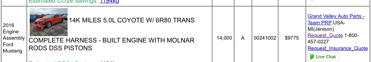

oh I know...just trying to add to the "fire"
I dropped the idea last night in conversation with the wife, she didnt shoot it down so thats practically a yes lol. the 5.0 swap WILL happen, a 5.4 2v is too much work for not a lot of gain, I dont hate myself enough to put a 3v in there on purpose, and a 6.2 would be a tight fit. 7.3 being the only logical other option is 2-3 times more expensive right now than a gen 1 5.0, so 5.0 it is. For the cost to rebuild a 4r70w (about 2-3k last I checked) I can replace it with a 6r80 with an engine and wire harness attached to it for the same price. so even if the 4.6 is healthy, that transmission wont last forever, only one of em has to break

That listing I posted above, does include the 10 speed...just sayin'

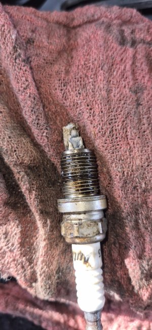

its worth noting that these plugs were just over a year old, but he said with confidence its not the spark plugs, which I didnt think so either but I checked anyway. this was the worst one, but 3 of them had baked on limerock

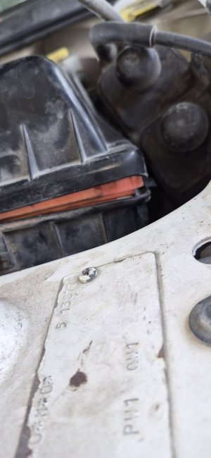

3011
The airbox, obviously not closed, sucking dust straight into the engine. how does a mechanic miss this?

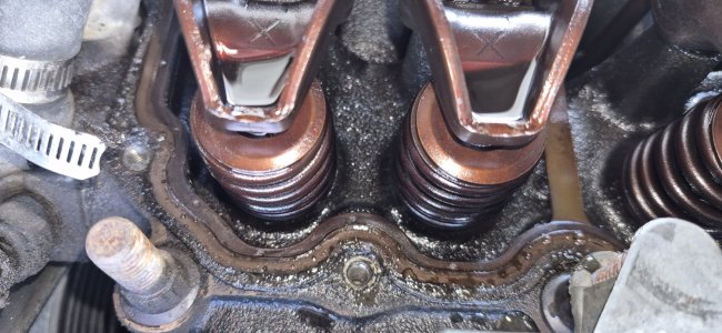

and an honorable mention that the hack didnt have anything to do with. look at how clean that is, there is NO sludge at all, a testatment to regular maintainence and Rotella 15W-40.

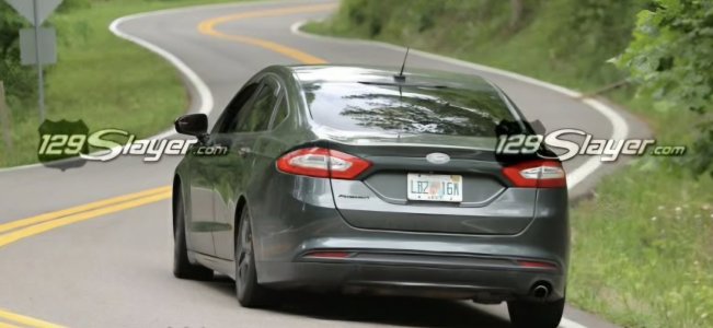

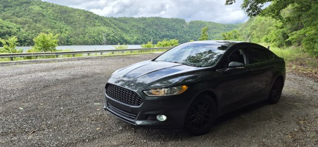

Ran up the tail of the dragon for the wife and I's anniversary, decided against taking the Lincoln but somewhat regretting selling SHO, the Fusion did great but I could only imagine how the SHO would've torn through the curves
Messenger creation AF40B3F4 1CF0 485B B4D4 A5940AC70B69Messenger creation 4139BC9B EB81 44CC BEBF 309DCCA6A8EAMessenger creation FC173D70 15A6 4ED3 9768 5317E01BCD6720260524 132727
Now I've got all these ideas of what to bring next time. Crown vic buggy, fox body, FPIS, 90s thunderbird with IRS. I pulled off 11 miles in just over 20 minutes, I wasn't pushing very hard because I already got the talk after the Vogel State Forrest on the way up to not drive like a teenager and make our kids orphans. But for a stock 2.5l NA Fusion she did great. I love this platform and the scenery is amazing. I got a hyper lapse video of the entire thing too
