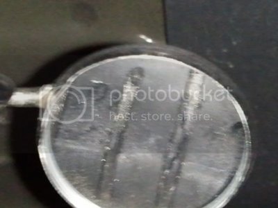

WP 000437
WP 000438
WP 000439
These are pictures the night of the incident while adding air at one of many stops. Obviously still on the car. I will get more pics tomorrow. The mirror is about the size of a quarter (it's included with the TMK in the trunk)

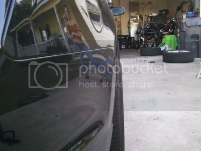

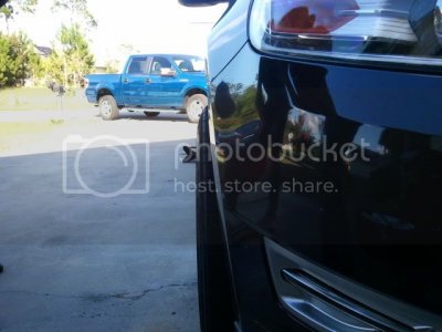

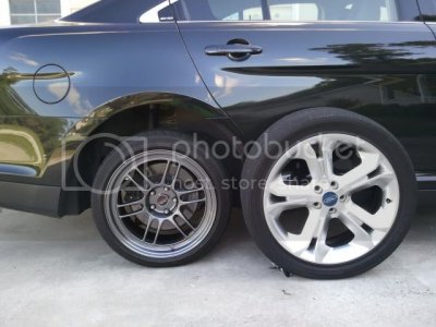

A test fit. Even after imagining a 1.5 - 2 inch lower...I may have to go with 19" wheels
WP 000450
WP 000449
WP 000448
WP 000447
WP 000445
WP 000444
These are 18 x 9 (or 9.5) with 15mm offset. 245/40R18 tires. Says that 275 will fit. About 20lbs per wheel.
I estimate the 275/50R18 is close enough ratio for my stock. Can't remember what the 19" was.
How wide can we go before rubbing is an issue on front/rear with/without lower?
WP 000448
:rofl: car looks silly like that i dunno why you'd bother bolting them on
anyways stock 19" size is 255/45/19 which is what i'm using for winter
search online for a tire size calculator that shows the size differences
the one i use is this one http://www.miata.net/garage/tirecalc.html
h1h0silver
Jan 23, 2004
96
saint marys, GA
I agree it looks silly, like a roller skate. I was determining difference in width and offset. Also thinking about smaller wheels to save weight but the tire height may add more and cancel out the savings
