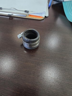

New flash this is CAP off whatever it was on. Guess I WAS orgionaly right turbo inlet? But why?
(possible intake hose broken no air filter)?
So I'm down to one turbo now?

Just looks like a cap someone made to vent to atmosphere. To do that you remove hose. Keep the recirc valve open and cap the bottom inlet. The other end of where the hose went. Thats just a cap that was clamped on. They get pretty oily and nasty after a few months and rapidly deteriorate from oil and temperature changes. I used silicone caps when i had it done. And actually that is a chair foot cap that can be bought at home depot as its the perfect fit. They work but crack quickly like the one you took a pic of
