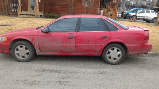

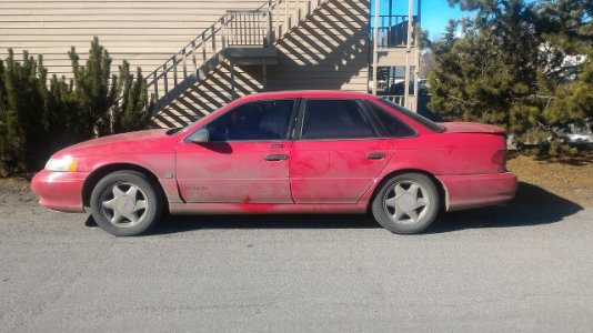

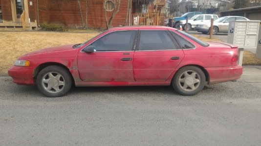

Heres a before and after.
AMtPiD
Deqoaj
they are nearly identical if anything slightly lower.. the new springs will also settle a bit. my rear tires are 60s and my fronts are 55s so it looks a little weird.. it was a cheap attempt at leveling it.

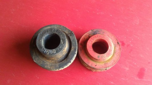

Another strange thing, my frame side radius bushings were Clevite. and very interesting ones at that. the red part was hard like plastic and the other part was normal poly. strange.

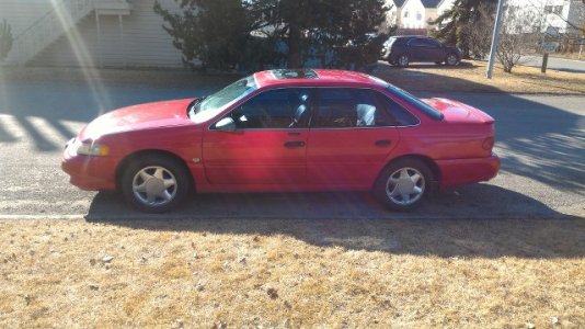

anyways, heres how she sits now
FmE3Dg
Worlds of difference.
now its time for a bath. lol
