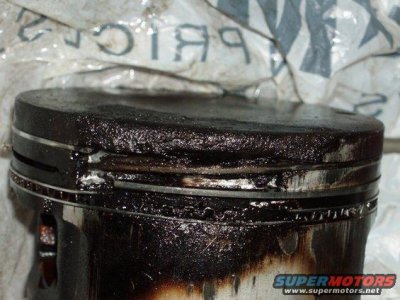

I sincerely hope it is a coil pack. My P-0305 was a lot worse.
Tightpiston2
Of course you should only experience this kind of damage from a little to much oxygen in that cylinder.
