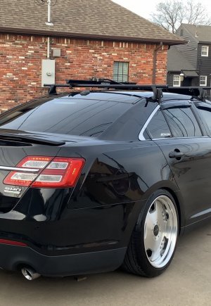

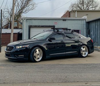

Childhood dream roof rack is finally on the 13 Taurus.
Couldn’t find one like it online so here’s all the bits it pieced together.
2 Yakima Q34 clips
2 Yakima Q116 clips
4 Yakima Q-towers
4 Yakima Q-tower base pads(type A)
2 Yakima 58” roundbars
4 Yakima SKS lock cores
Yakima roundbar endcaps
Yakima 50” wind spoiler
Yakima lockjaw bike carrier
Total cost:$601.19
Metal mounting clips have a layer of tape & hobbytown adhesive crafting foam, didn’t scratch paint.

Like your wheels

Where did you get the wheels from i'm having a hard time locating any 20s online
I found them on EBay. Not sure how hard it’d be to find another set, I believe mine were produced in the 90’s and I had to get them shipped from Japan. They usually have some on Croooober.com
