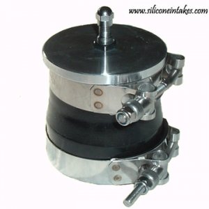

Matt , it yould be nice to have the option for REALLY nice T-clamps to match these. I would be interested in those.
