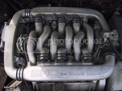

Someone said dying fuel pump or pressure regulator. Where is this regulator located?

The regulator is the circular thing with the vacuum hose attached to it next to the blue wire
SHO
If you want to test fuel pressure, grab a fuel pressure gauge from one of the auto parts stores, then on the opposite side of the engine there's a test valve that's just like the one used for filling up tires that it hooks on to. The specs are:
KOEO = 30-45 psi
KOER = 28-33 psi
Something else you can try is disconnecting the O2 sensors and going for a cruise, it may be that that connector is so far gone it's making the ECU freak out. The car won't run great at low RPM's and loads with them disconnected but it should be drive able and tell you if that's the problem or not.
