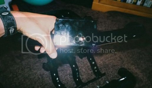

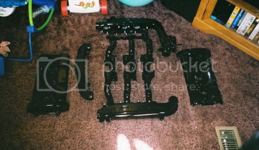

whaddya think?
6386935 R1 043 20

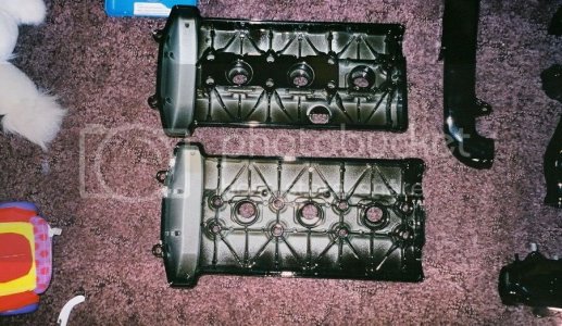

oops? Is this bad?
6386935 R1 047 22
6386935 R1 049 23
6386935 R1 045 21
Does any one who powder coated theirs have a way to paint the TB and secondary assembaly? I can't get the blades out but I have cleaned em pretty good.

Yeah the parts should have been tapped up where you didn't want powdercoat, I'm surprised the powdercoater didn't think of it.
Now you have alot of material to remove and you need to be careful so that it doesn't start to peel on the parts that need to be shown.

This cost $102 after tax and everything. I don't know why he didn't tape the gasket surfaces off. He taped all the bolts and plugged the holes. :bonk:

That's pretty cheap for as many parts got coated and all the extra coating where you didn't want it. ;)
This should look sweet when you have everything installed , I can't wait for pics. :salute:

Well, I think I'm royally screwed. Upon closer inspection of all the PCing I had done I found out that the only thing that powder DIDN'T get on was the screws on the tanks and 1(yes one) screw on the TB side. It's in the DIS screw holes, on the plug well seals, in the oil cap holder, some in the tanks and under the valve covers and in the brcket holders(all of them). AM I completley jacked? :frown:
I guess $102 was to good to be true. :rant:
