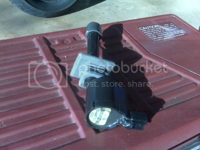

Its not but you can buy the cdi module to make it work. It says not using the cdi module may even damage your motor. There are 1000 hp dsms using this setup. I'm going to try these 300m coils. This is a inferior coil to the aem type but it is better than plug wires. I've seen some 4g63s running 800hp with the 300m coils. The reason I won't just use the coils out of the duractec is the fact that they don't seal on the valve cover well by themselves. Then, the way I mounted them in the stock plug boots makes them stick up too high. The 300m coils aren't as bulky.
I guess i skipped over that part. Is there a list of coils somewhere on the forum that can be used? i know the duratec coils have less voltage from reading some threads but there has to be a car that has coils available with more power or same as the stock sho.

I don't know. If you look up performance coil on plugs in google you will get a bunch of different brands that make the duratec style coils with more spark. I'm sure the aem coils give plenty of spark with the cdi module.

Duratec Coils produce a very strong spark. Be careful with aftermarket because there not always made as well as OEM.
One more note, the stronger the coil the bigger the back lash to the DIS module after that coil fires. I don't know how strong the check valves are in the DIS module, but if you exceed them you burn out the primary ignition controls. This is why some vehicles require additional resistor.

Ok here's some results with my research.
I have visited many mustang forums , specially looking for aftermarket COPs. From what I have read , MSD is meh , Accel is no-no , Grenattelli is meh , and is seams that WeaponX is the ******* (really good).
I will contact them for further infos cause they make them for universal purposes with 4 custom heigths. Ill also ask if you absolutely need a damn module to run them.

this may be something for shosource to check out. A wire harness is easy to make, if the company wants to test one of their coils on a sho.
i actually put some factory ford coils in tonight and its missing and backfiring quite a bit. so im going to check al my wiring in the morning.
