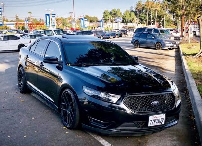

I've had my staggered setup for nearly a year and I LOVE it. It looks so good on a big car like this. Compliments and stares all the time. Ever since I had my 7 series BMW, I was hooked on the staggered stance. Then my Lexus LS460 got the same treatment and now my SHO. Speedometer change is minimal and inconsequential...at least to me.
