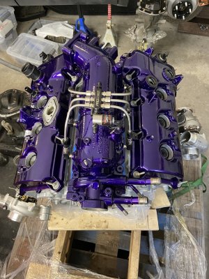

I’m not sure how much this will consume but 2.0 GPH nozzles (196cc) per cylinder and 1000cc pre tb. D6414C5F 5B9C 41A2 848E 89430DBCFB00
Per cylinder is ensuring even distribution and wanting to keep at least 1000cc pre throttle body is where the major drop in IAT2 temps will be from and the majority of the power gain, not from 196cc direct port. So if you add direct port that’s just icing on top, still need the cake…keep pre TB potent.
