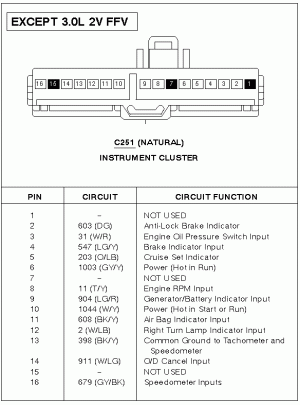

Hey all, I'm looking a photo, copy, email whatever of one page out of the Factroy Ford SHO Electrical manual.....
The page I need is under Instrument Cluster it would be the very last page in the section where it shows the Pin placement if the cluster wires. It will have a drawing of the cluster pigtails and say something like C250 C251 and than pen 1-16's placement. I know in my 1997 Tbird manual this is on page 61-8....

P.S. The past owner of my car tried to swap a MN12 cluster into the car messing up the placement of all my wires. :(

Thanks for the idea, sadly the item I need is in the Service manual. The shop books Ford has. I could buy the book from eBay for 8 to 20.00 but I only need the one page.

The books are no where near as complete as the CDs of DVDs.
