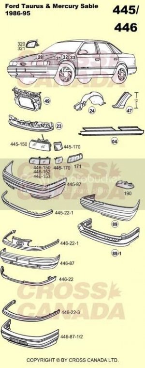

Heres a pic from shermanparts.com. It's number 23.

Actually the whole front clip is interchangable with a sable. And since you're in Mi. (depending...) you can pick the parts up brand new from shermanparts without paying shipping.
