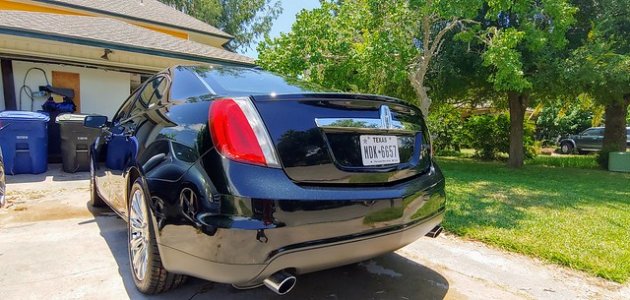

I'm a big fan of the Optimum car care line. After I bought my MKS Ecoboost in June I did a complete detail with their products finishing with the Gloss Coat topped with Opti-Seal which is a maintenance sealant I use every wash. GC is super easy to apply and should last 2-3 years. I did the same thing to my 06 GTO that I lost in May to flood damage over a year before it was gone and the coating still looked/performed like day 1. Very impressed with the Optimum line, here are a few pics of the MKS.
20190711 131345 HDR 20190711 131802 HDR 20190711 132034 HDR 20190711 131700 HDR
48264112862 6100338244 z
