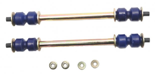

Well the struts came in and I got the right side out and while taking the link off it snapped in two.
Just for the sake of conversation . Can I install the struts and then put the links in after its up and running?
Do I have to wait on the links and do it?
Need this car to run .

You can get end links at any auto parts store. Go get new ones and do it all now.

Anyway Joe (Napa) and Cal (CarQuest) both say they can get them by Tuesday for sure.So the question remains..
Just put them on later or let her sit in the shop all weekend till Tuesday.

I'm driving the car around and waiting on the links.

Don't forget to jack up the wheel or knuckle when you install them. They're not long enough to install when the car is jacked up with the wheel/hub at full extension hanging down.
