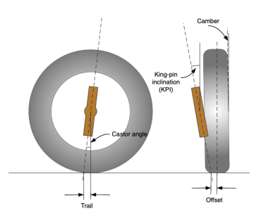

With such wide tires, and what I suspect are aftermarket rims with a different offset, and possibly different diameter altogether, placing the tire outside of the "center" of where it is stock, this might have something to do with the SAI (Steering Axis Inclination - also known as King-Pin Inclination or KPI).
Because of the changes, the various angles are out of the right "zone".
When you're on level and even roads, the forces counteract each other. Once you get one tire on a different surface, it'll pull to one side.
At least, that's my theory. When I put larger diameter tires on my F250 using the stock rims, the steering was worse in terms of exactly what you're describing. The reason being that the SAI fell outside of the zone it should be in, in terms of where the SAI hits the pavement, and where the tire was in relation to that. If I had gotten rims with more of an offset, that would have put the tire back into the right zone. In my case, the SAI had moved outwards. In your case, if the tires are the same diameter but you have more offset to tuck the tires in deeper into the wheel wells, your SAI has also moved towards the outside edge of where the tire meets the pavement.
