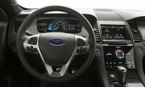

Capacitive buttons on the head unit?
Mine's a newer generation than that. The buttons are actually touch buttons, not physical switches. I should also mention that it is not cold in the morning where I am, only about 60-70 degrees at the lowest during this time of the year
Layout is identical to the below image, but the sync version is more up to date than the one in the photo.
2014 Ford Taurus Sho Interior

I forgot that video was with my old 2013.
My 2015 with the Sony headunit is like the one in your pic. I believe they both use capacitive buttons. I had issues with temp and sometimes audio control. Can't recall if dealer replaced the faceplate or the whole headunit.

Looks and sounds to be very consistent with an issue with the FCIM, and more specifically, the little ICs for each of the capacitive buttons on the FCIM. The FCIM is not difficult to replace, but can be a bit costly and not always easy to find on the used market.
I'm starting to read about enough of these that it might be worth starting an FCIM scrapyard to rebuild units with parts from scrap units. At least on the FCIM for my MKS, the parts are not available to the consumer and I wasn't able to identify any drop in replacement parts.
