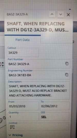

Irish Pride
Irish Inside
Dec 23, 2007
3,747
4,796
MusicCityUSA
When replacing Right CV axle you also need to replace the intermediate shaft, the mounting bracket, and all associated hardware. Once the shaft, and bracket are replaced everything will mount up the way that it's supposed to.
Current Ford part number is -
DG1Z-3B436-E RH CV
DG1Z-3A329-E Intermediate
DB5Z-3K305-B Bracket
all are readily available
-Chad

nikkoruscio
Feb 28, 2025
Lafayette
DG1Z-3B436-E RH CV
-Chad
What parts program is that??
