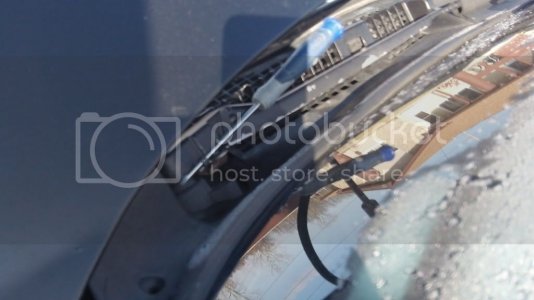

100 0059
I've got the pin pulled out in that pic... if you can pull a little tab there out and drop it on, push the thing back in and it should be good. that tab is part of that bigger clip. should be easy to see.

Oh, that's not the part I was thinking of. I have those. The part I am talking about is where the armature connects to the wiper motor itself under the black cover.
