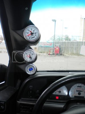

I think most WB packages use Bosch sensors anyways.
I had the AutoMeter C2 setup and absolutely loved it. They are one of the more expensive setups though.
