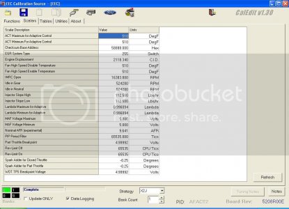

Tonight I put a new battery it, but it would crank and not start. I looked at my tweecer program I had under scalers and everything looked right:
Mytune
But when I 'read EEC' I get this crazy setup:
Problem
No matter how many times I try to write to the tweecer, clear KAM, etc, it doesn't run, and that crazy program stays in the EEC. I can take the tweecer out and it starts right up.

I was looking at your screen shot, and noticed you only had the data logging button checked.
TimboSHO
Intermediate
Aug 22, 2002
2,274
727
Wyoming, MI
I tried checking the 'update only' button as well as having both checked, but it didn't make any difference.....
