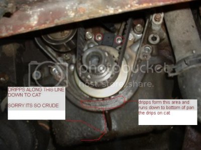

its the seal behind the crankshaft pully. the big one on the bottom so it might be a leaking oil pan gasket, but its deff oil not my wp its not fast flowing. I did some hwy drivin and checked right after i got home and i can see the oil, little line dripin on the cat making smoke so i guess we have to fix at the meet any ideas for anebody
can any body show me a pic for refrence right behind the crankshaft pully thx

i think you'd be better if it was your waterpump... although i dont see how the front main is leaking onto your exhaust... maybe yourcam seal behind the cam sensor?... mine is leaking there and maybe your front main is leaky too?... i just dont see how the front main is leaking onto the exhaust..

front main can/will leak onto the front converter. Mine's doing as we type.. :doh:
The front main requires removal of the Dampner/Timing Belt/Timing belt sprocket.

yea thats what it is sasho91 i can see a line of oil coming form the spot wish i could take a pic is it easy enough to fix?

Yeah mike that would def. be a front main if its leakin on to the cat. Mine did the same thing too. Its actualy not that hard changing it out. Just be gentle :)
