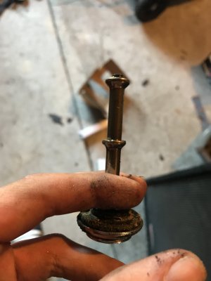

Actually the one pictured was broken when I started digging into the valve covers, I got the intake off and it was just kind of floating around in the hole. I’ve got an extraction kit but I’ve always had bad luck on the drill bits and, let’s be honest, who likes heli-coiling

Luckily won’t be heli-coiling or drilling anything. Was able to do the classy vise-grips grab. On an unrelated note, know where I can find the metal transmission cooler lines for an ATX? only parts MTX’s near me and can’t find it anywhere
13,265
Ahh I assumed they were it snapped sorta flush. Vice grips saved the day. Tighten those things to snug and not real tight. Very sciencey precision there.

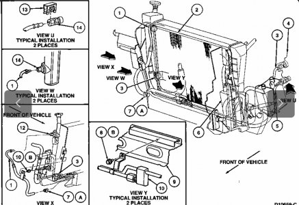

So I did some looking in the forum and found this diagram in a thread:
344B5A7B 418E 4CBA 9B91 6EF175435E32
I’ll include the thread on this reply for anyone else that has this problem, but mine are just as rusty, if not worse, than the one pictured there. But exact same problem. I think I’m gonna end up at the dealership hoping they have some.

Really need an oem part number to cross reference. Some dealer parts places don't like to give those out so you don't shop around. I've found with obsolete parts they will gladly give those numbers out as it is moot for them at that point. IF you get a number get all teh ones from 93-95 when the autos became available. Those should be same parts with maybe a slight number change.
I have not seen anything new for these in a long time. If there are rust free(ish) used ones that might be the answer or custom built replacements.
